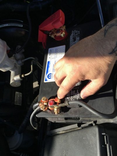

First things first, disconnect your negative battery cable:

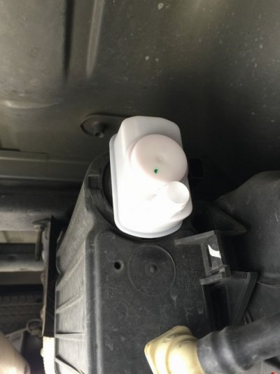

2nd - Locate your EVAP canister which is located on the inside of your gas tank:

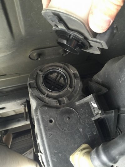

4th - Locate the small tab/clip on the bottom of the emissions detector, lift carefully with a small flathead screwdriver and at the same time turn it clockwise quarter turn and pull straight out, once pulled notice the small 4 tabs, these line up with the canister when you install the new emission detector:

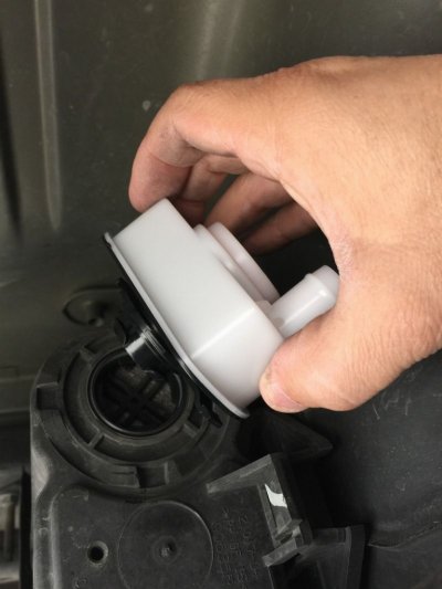

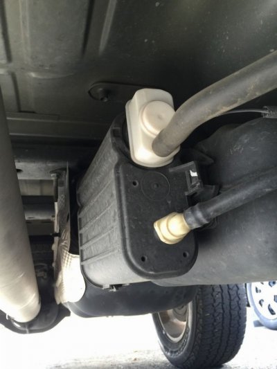

5th - Now, everything in reverse. Install the new emissions leak detector, press inside making sure to line up the tabs to the canister and turn counter-clockwise quarter turn:
Reconnect your sensor plug and rubber hose to the unit:

Filled it up this afternoon and no issues thus far :)
