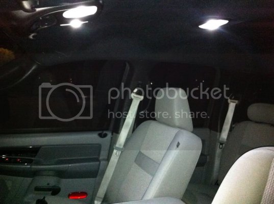

BlackedOutHemi
Feb 27, 2011
5,454
198
DFW, Texas
2012 & 2012
5.7L HEMI & 6.7L Cummins
Never really did get any finished pictures. Haha. Just a couple. But no close ups. All shots from the drivers door. 875f06e2.jpg
