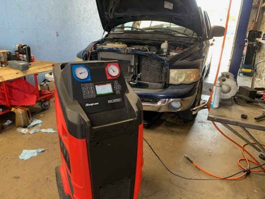

I evacuated and recovered and then put in the measured charge (well, I tried) as when it came time to start the engine to suck up the remaining charge from the machine, the darn clutch wouldn't engage. I thought for sure that I really broke it now BUT the next day when I returned to try and figure this out, low and behold, the clutch was engaged and the vents were blowing cool... of course the machine with the remaining r-134a was five miles away... When I get it all working as it should I will go and pull another vacuum and charge. A long, deep vacuum...
My initial thoughts were that someone had been messing with a Walmart 134 charge hose kit and likely put a slug of air into the system. Step one, put a known measured charge into the closed system.
My friend has a auto repair shop and all the good tools including Snapon and Autel scanners. The Autel I had didn't give me the ability to manually engage the clutch so I didn't finish the charge but I did change the receiver drier and both Schrader type service valves while I had the system empty.

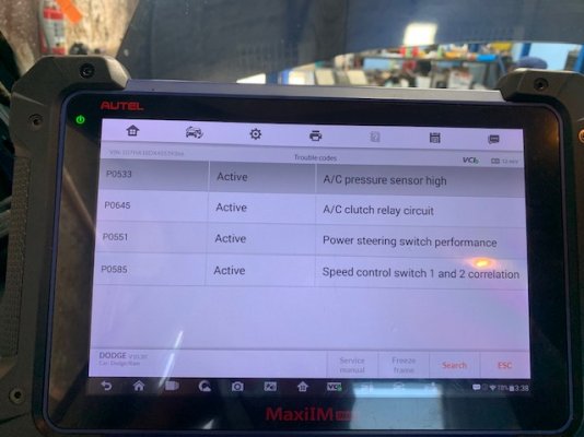

These scanner shots are from the HVAC sections. I would read them, take a picture, then clear them and see what came back as a hard code.

View attachment 523847View attachment 523848

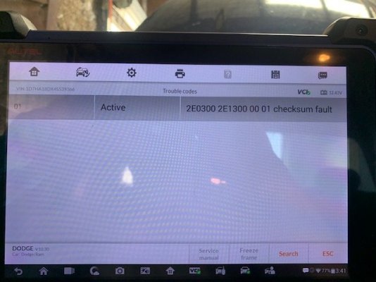

Can you explain what the check sum fault is and how it would be cleared? Isn't it a handshake of sorts between all the modules and somehow this HVAC checksum ( some module or modules ) isn't to be trusted because it is not recognized as a member of the collective network?

Back to the CheckSum Error on the HVAC page of the scanner... Is this something that the dealership can do without replacing a lot of expensive parts (the PCM)?
Is it just an polite introduction at a party?
A few swipes with a propriety DRBIII tool??

My suspicion is that when some ham ****** dealership mechanic was in the dashboard trying the second or third time to replace the TATATKA passenger killer and maybe they had to get in around the hvac wiring??? And perhaps didn't properly make up the ETS connector? ...and now I stumbled upon it and although it may appear to be working for the interim, that I am still not sure the connector is made up, *[click N little red slide locked]
