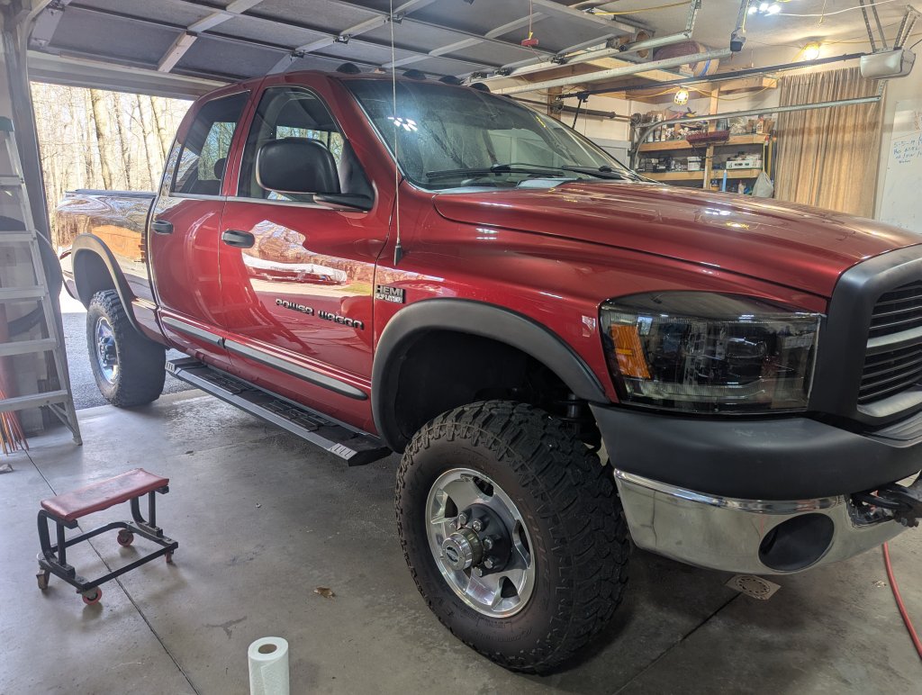

I picked up a 2007 Power Wagon with G56 in Feb of 2025. The truck runs fantastic, no issues no codes and I've put nearly 15k miles on it. The one issue that I can't seem to figure out is this throttle lag at times. I am trying to determine if there is anything I can do to correct it or if it is just normal behavior.
When coming to a stop and the RPMs are dropping, there is zero throttle response. For example, just push in the clutch and try to blip the throttle and absolutely NOTHING happens. Once the RPMs drop down to idle all is good, response is back.
I even ordered a diablosport tuner and have so far applied the 87 tune (until I run the 89 out of my current tank) and upped the throttle boost to 20%, this is clearly felt but the same issue persists, dead throttle when RPMs are dropping. I cleaned the throttle body, wasn't overly dirty but a bit sticky but no change. Am I missing something or is that just how these thing behave?
