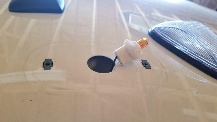

Don't know how much this will help, but this the lights on my '18. The bulb holder twists into the light assemble then the 2 screws squeezes' the gasket down. Just be careful not to over do it when tightening.
This is the clear 194 bulbs (IIRC). They look yellow/amber but it was the color balance off on the phone. A can of VHT night shades would be also be an alternative and tint the stock clear lenses. I was going to do that, but just too lazy anymore.
