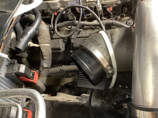

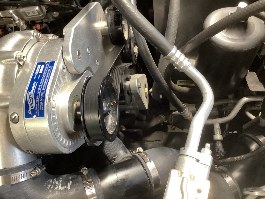

I might as we post a blower tradesman.It was a kit that didn’t exist when I called so they told me I was 1 of 250 slated to be made after the mock up. It involved removing the grill shutters for the intercooler then removing the overflow and air box.Fitting all the brackets and a 90 for a heater hose to clear the belt. New MAF injectors plugs PCM and a **** welded into the ex.pipe for dyno.25F237AC-C260-4270-A74F-553C8B16D7A0.jpeg7C562CE3-95E3-4A35-BF4B-AF8BB04C8605.jpegFE287E1D-268F-48CF-9E6E-D7E93CDA0DFC.jpeg

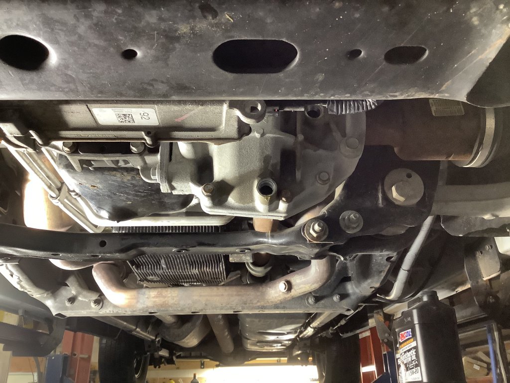

Been a while but the ATI damper has been on since shortly after the original post. The engine definitely revs faster and idles smoother. The True Trac went in a couple months ago. Prior to the TT I had a weird shimmy in the rear end when I would get out of the Throttle after a hard run. I believe it was the open diff shifting power between tires. The TT has eliminated the shimmy. The truck will now lay down 2 black marks so I think it was worth it.
