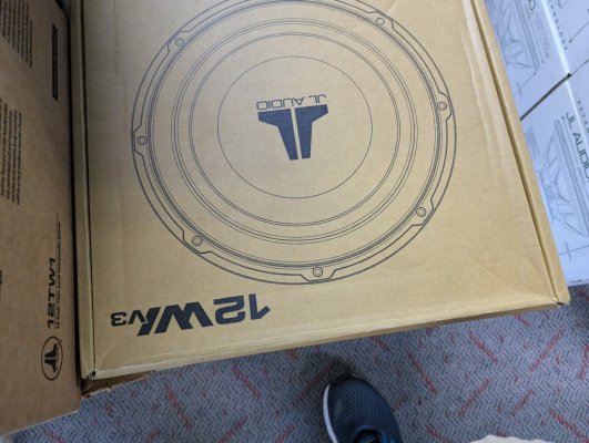

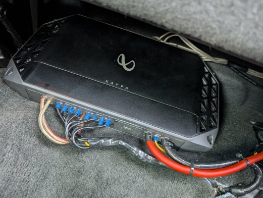

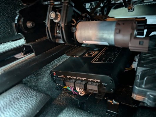

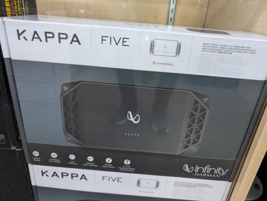

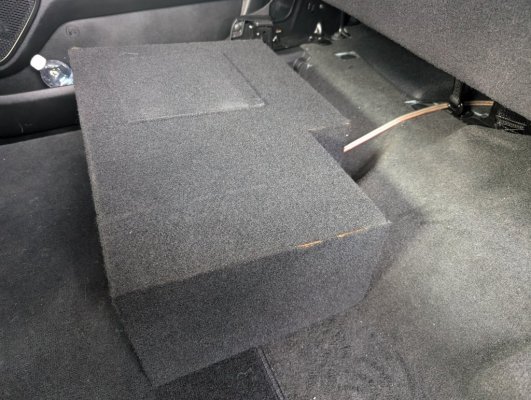

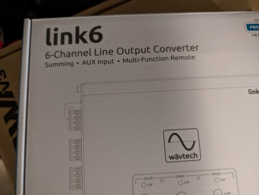

I bought the 6 speaker replacements on Crutchfield and installed those myself. I have the base 6 system (not Alpine). Then had a shop do the amp, sub, ANC bypass, and line output converter because that's beyond my ability.
So started with all Infinity Reference speakers: 4X 697F 6X9 (doors), 2X REF307F 3.5" and no amp. Ran it like that for a few weeks before impulse buying, having the shop do the rest.
Sub - JL W1v3 Series 12" 4-ohm subwoofer, installed in a sealed box. Under the passenger side back seat.
Amp - Infinity KAPPAFIVE 5 channel, running the sub and all other speakers. Under the driver side back set.
Line converter - Wavetech Link6 - under drivers seat near the factory ANC and PAC module.

If I had to do it again, I'd probably buy a box from Fox Acoustics. They have custom boxes, single and double 10" or 12", that seem to get really good reviews. Still might eventually get one of their boxes. Might end up adding a dedicated sub amp and get a second sub and new box. They're singe 12" box looks really slick, though it's ported and I'm probably better off with sealed for rock music.

Ahhh, nice post, thanks for the details and pics. :waytogo: :waytogo: I already have an amp and a single 10" sub. I need sub box (sealed) and wiring and adapters.
I might deviate from my beloved Crutchfield, I am looking at these guys NetAudio , I have been watching their YouTube vids. They seem to have a real good handle on the RAM systems, and all the special wiring, adapters, ANC bypass, etc.
I am looking at these guys NetAudio , I have been watching their YouTube vids. They seem to have a real good handle on the RAM systems, and all the special wiring and adapters.
I'm familiar with their products. They make good stuff, I'd consider them if I replace my box.
I'm on a Ram 1500 FB group and many recommend these guys (and Fox).
This is the Fox box I was looking at. I would just ask them to seal it. Though if I stick with sealed, the Netaudio might be better.
This is what the Fox looks like:
