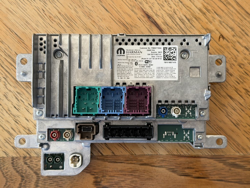

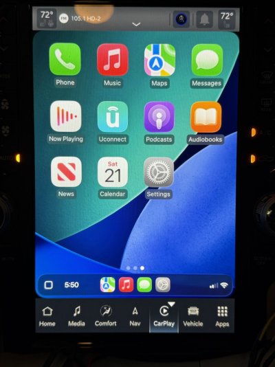

Hello, If you have a 12" Uconnect 4 (UAX module with wired Carplay/Android auto) in your truck. It is possible, (and worth the upgrade) to go from Uconnect 4 to Uconnect 5 (wireless Carplay/Android auto) in your RAM 2019-2021.
You just need 3 Items:
- A new Uconnect 5 Module, Part number 68504644. You can fin them in eBay, just do a search for that part number
- A new 12” screen (the old one is not compatible, the touch screen won’t work) I can supply Part numbers, There are different types, depending in the options of your truck, extra push buttons are required on the screen.
- A complete upgrade Harness kit (widely available in eBay for $100 or less)
- Some programming is needed, only if you are upgrading for a smaller 5” or 8.4” screen. (If you already have a Uconnect 4 12”, your truck is already programed for a 12” display)
BE CAREFUL WITH THESE PART# MODULES, 68598596 (only for 2025 RAM) 68527730 (Only for Grand Cherokee and Wagoneer) These modules run on the new CAN platform Atlantis, They won’t work in 2019-2024 RAM trucks.
