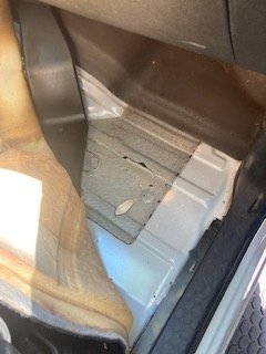

Is my leak in the floor board
goatiegoat1
Oct 29, 2023
16
ny
I keep finding passenger floor wet. I have attempted to seal roof seam and anywhere I believe could leak. I pulled the rug back and I questionif the floor is original or patched (purchased used).IMG_0202.jpg
G
goatiegoat1
Oct 29, 2023
16
ny
1746815126238.pngI purchased 2015 ram 1500 used I keep getting water on passeger floor. I question if the floor is patched. should floor look like this.

Common places for our trucks to leak are from the third brake light - the vents on the cab behind the rear seats - rooftop antennas - poor seals around the glass
Lots of info on our database to help you make determinations and repairs ;)
Daw14
Nov 29, 2017
3,429
5,477
South Florida
It could be your a/c condensate drain, it’s on that side .
On the firewall under hood on passenger side is where this exits the cab . It’s a 90* rubber hose that is crimped on the end , this normally drains with ac on , sometimes the crimp gets crusty and causes it to backup and overflow in the cab.
This is where I would look first , next I would think maybe around the windshield . This would need to have water sprayed at every angle you can manage , as when at speed the water may run up from the bottom and cause leaks
Could be the heater core too , but it would smell like antifreeze.
Hopefully this gives you an idea where to start searching .

Cabin Vents leaking, usually wet under rear seat, or cracked slider window frame or slider rear window drains clogged, that rear passenger door, are the drains clogged causing it to get into the rear floor.
jws123
May 16, 2018
3,213
4,373
nj
Since this is the passenger front you have 1 of 3 issues. A/c drain is clogged most common or windshield is leaking around seal if it was replaced Or your heater core is leaking see if it smells like coolant,. I have never heard of any other water leak in this area what they are talking about would get your rear carpet wet.
