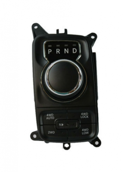

What you see on the RAM video you posted though is a RAM equipped with the non-so good offroad transfer case, BW44-44. You can easily recognize the system because you'll see a 4auto option in the rotary switch or push button switch to engage 4x4. it's a clutch pack type system and the clutches are allowed too much spin, they get hot etc etc. There is a dude in the forum that came up with a kit that can lock up those clutches hard so they won't slip. The 44-45 is chain driven and it doesn't slip at all, no need for special transfer case fluid either. Combine the 45 transfer case with a factory rear LSD and now you have a well rounded expedition/overlanding package, you also have the option of adding a rear truetrac if you wanted as well, Or If you want a rear locker you can get it with a 5th gen RAM 1500 with offroad package. BLD works in 4hi or 4lo, don't forget to turn off your traction control in 4hi like you will with VCD. 4lo will turn off traction control automatically.
This would be example of RAM 1500's equipped with the 44-44 transfer case

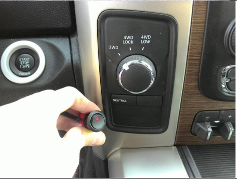

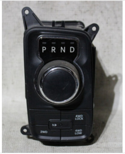

This is how a truck equipped with 44-45 transfer case will look like when you look at the 4x4 control, this is the one you want (No 4wd auto in the options).

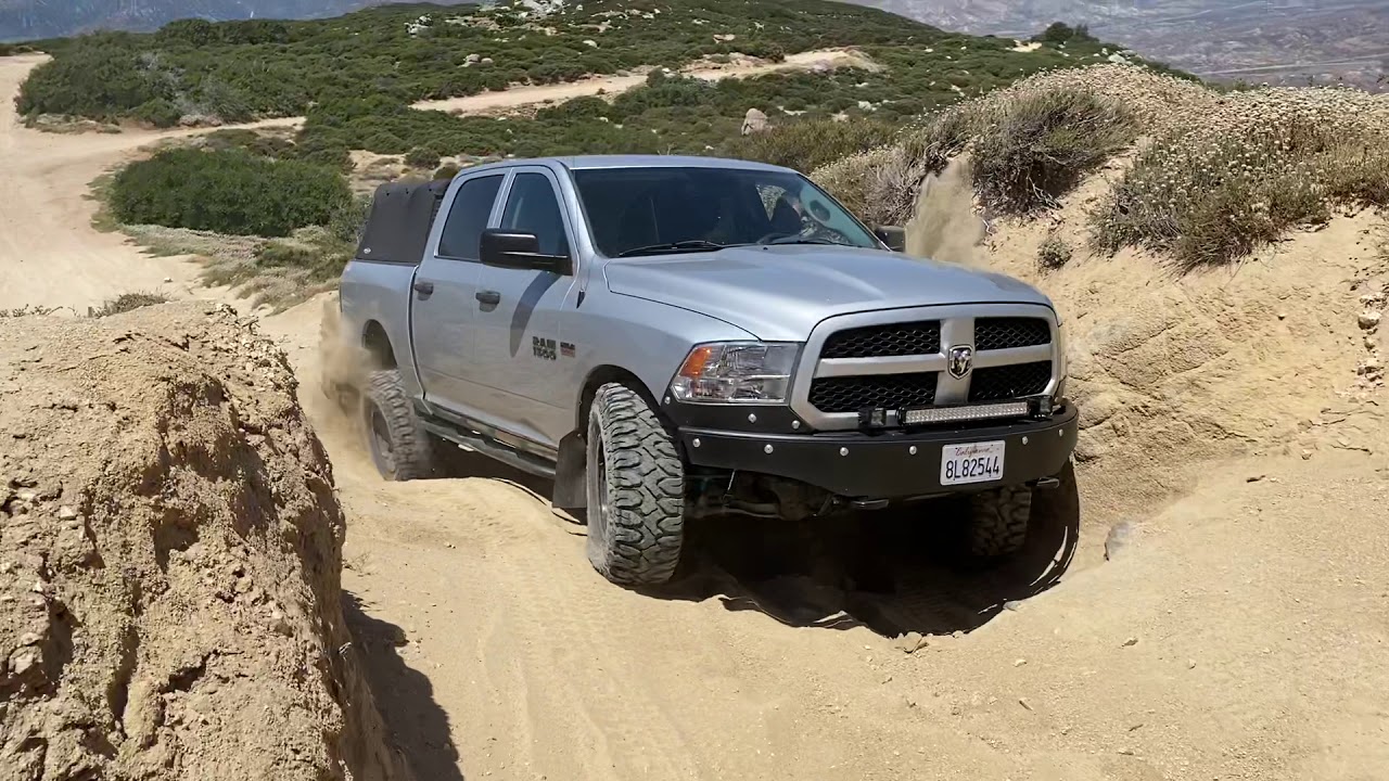

This is my RAM truck on 37's with the 44-45 transfer case and BLD in action
or 35's on something more loose
I also have a 2018 Jeep Wrangler Sport so no locker no rear LSD and it goes everywhere just with BLD. Granted i'm not doing King of the Hammers with the thing but i have fun with it.
