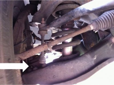

Trying to figure out what the thing is to the left of my stabilizer link end picture. Is this what the parts manual calls BUMPER, Jounce Right or Left with a part number of 52106576AA?
Mine are completely deteriorated and need replacing.
Anybody have any good suggestions? Does this just pop out then pop another one back in?
Thanks for your help!

That's what is looks like but hard to tell from the pic.
From the description on your other thread is sounds like it.
Just 1 nut holds it in place. Easy change.

Years ago I wanted to replace the OEM front bumps and found the dealer wanted something around $30 ea for them. Bought a pair from a salvage yard for a couple of dollars. They just pry out. IMO, aftermarket has much better pieces like Timbren rubber springs.
