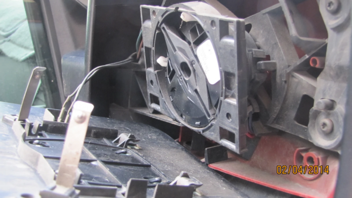

I still think those mirrors did not come stock on that truck
2009 mirrors used this tilt motor

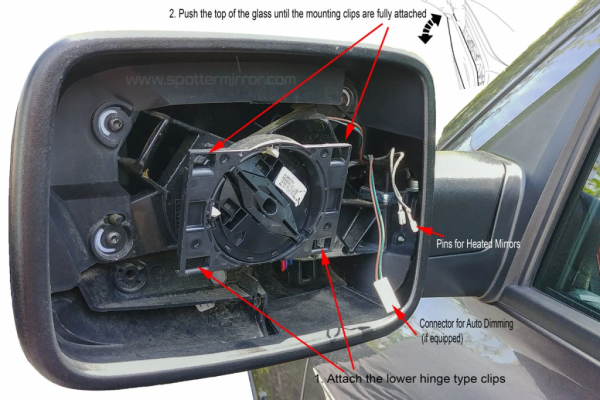

2019 - 2023

I'm not sure if they're stock, although they look like what Rockauto and Amazon both suggest for me for my make/model? But I will say they look like no 2007 Dodge Ram mirror video I reviewed.
But yeah the motor works. So I might just see if I can goop it. It doesn't want to join back to the old surface, but I may be able to force it or layer something in there.
