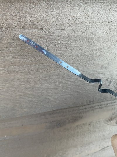

drl257
Apr 16, 2017
So I’m up to 10 quarts of fluid added now and here’s where I’m at. Tranny is reading 100F after running for about an hour. On a positive note it does seem to be running better now that the fluid level Isn’t quite as low.
