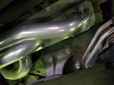

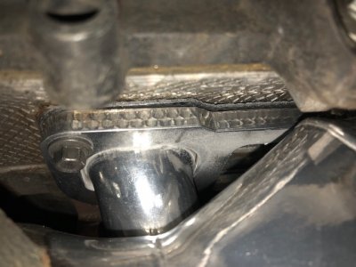

Hey All, so I just installed JBA shorties, used the JBA gaskets cause the OEM I bought have that MONGO heat shield, so then got the 6.1/6.4 gaskets, apparently dont have the EGR tube port...very frustrating...so now my passenger side isnt sealing at flange between tube 3 & 4. I am removing that header to check to see if warped...anyone else run into flange issues?
