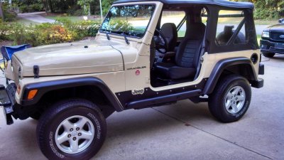

I don't have anything to contribute, I just wanted an excuse to post pictures of my 97 TJ. Just ordered some Quadratec's seat covers with the keeping bags that attach on the back of the seats and the Drake billet emergency brake handle cover that matches the shifter cover I already have..
