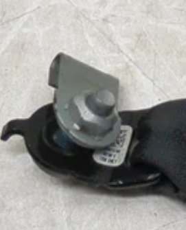

I just swapped my 2017 ram 1500 center console for a jump seat. The seat came with the male portion of the belt but I need to add the female end. I found that part easily online but I can't find this mounting nut pictured below. Does anyone know the part number? I can't find any pictures of that belt mounted either to see if I can get away with just a standard nut and washer. If anyone could give me some insight I would appreciate it. Thank you. SmartSelect_20241227_204021_Chrome.jpg

The jump seat on my 19 Classic (should be the same) had the seatbelts going into the rear inside legs of the front seats. That nut just clips onto the leg for the driver or passenger seat (I forget which one was the female side) as a locator to keep it from rotating during tightening.
As long as you can get to both sides of the bracket get some grade 8 hardware and tighten it up.

Great, thank you. That's what I figured but without clear pictures or the parts in front of me I wanted another opinion so I don't have to pay shipping on another other parts order if I missed something.

Also - i just happened to find that bolt and nut in my parts bin....... if you can't make something work and want to get the correct part, let me know and I'll ship it to you.
