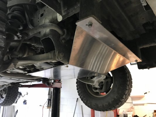

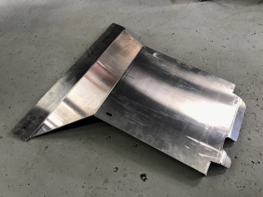

Okay update time! Skid plate is back from waterjet and fits perfect first try... well almost. Need to adjust spacing of the front holes, but other than that, pretty happy with fitment. Once the bolts are tightened, the fit is tight without any rattles.
1/4" 50 series aluminum, weighing in at 22lbs
Protects the power steering computer which actually is quite exposed.
open to any suggestions to make this better. I will look for bigger washers, the middle bolts uses big seat belt washers on the inside.

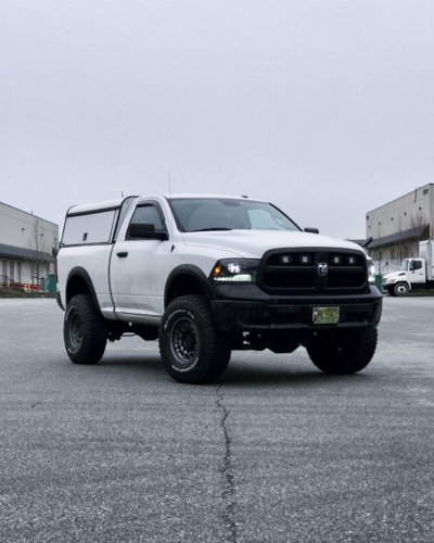

How time flies! A couple more months and it'll be a year of owning the truck.
Zone 6" lift with Fox coilovers and shocks.
Picture above was the 3" coils plus 2" spacers but I've since taken them out and it's now level with the front.
Installed Mevotech UCAs as well with adjustable balljoints.
17x9.5 Black Rhino Arsenal, 1.5" wheel spacers, on 37x12.5 BFG TA KO2s. I've since remounted the tires so the white letters faced inward.
This was a big install, took much longer than expected; but really enjoying the ride.
Next thing on the list is to fix the fuel sensor which threw a CEL light. Other than that, no problems with the truck what so ever.
