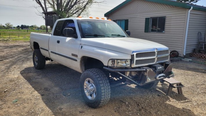

Had this pickup for 17 years. Bought it with 150k on it as dually. 17 years later its now a single wheel truck with 390k on it.
I hated it as dually. Love it as single wheel
Its been my daily driver work rig now its kinda my firewood hauler as ive got a coyote f150
The dodge has had all consumables replaced transmission i had refreshed at 180k. Then at 350k tourge convertor went out so i did a full build myself on the 47re.
All the goodies but just a billett single disc but built to my specs. Also did a full valve body reprogram myself after phone calls with gorend, transgo, power driven diesel, etc.
New transmission was a game changer truck is fast n fun to drive will light the tires from a roll

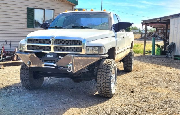

100hp soon to be 150 injectors, 62x65x14 3rd gen turbo(long story), smartey, 5" exhaust, 2" leveled front lift, customn track bar, 2008+ steering, morimoto led bulbs(nother game changer) run gtr in my ford.
Cant believe i ran ****** lights for so long. 200-300 for good lighting i can actually see the road with and good cut off is very worth it.
Front bumper isnt quite finished.

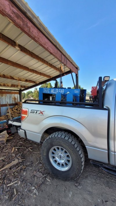

Wanting to build a flatbed but may do a headache bedrail set up similar to what i did on the ford. Due const of materials to build bed. Want a 1/4" deck $$$
Theres a 5500lb winch in the headache rack main use is for dragging snow bikes in the truck.
