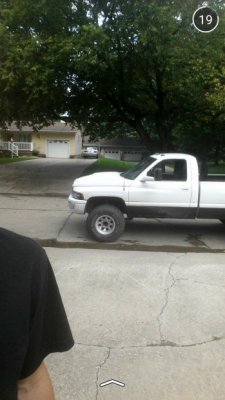

My buddy ran 35x11.5x15 on his 12v for a week while his cousins truck was getting worked on (cousins wheel/tire combo). He just had 2"lift springs on front to compensate for a plow. Could barely turn lol
