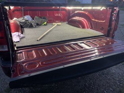

Last week I was loading some stuff I bought into the bed at dusk. I couldn't see in my bed with the tonneau cover on so it was time to get some bed lights. Thanks to a thread in here I found a led kit on Amazon for $20. It wasn't that hard. I tied into the towing harness. I did it easy way and just used their switch. I put that under the bed rails. I'm very happy with it.

Nice! I've been thinking of adding bed lights. I'll have to check out the thread you referenced.

I have the same lights. One of my favorite mods so far.

I used this wiring diagram which I found in another thread to splice into the hitch wiring. The pin locations were accurate but the colors were different.
Pin B (ground) was white and pin E (hot) was red.

For mine, I tapped into my towing wiring harness using these no splice wire taps. I used the switch that came in the kit.

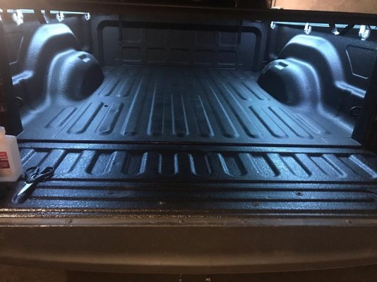

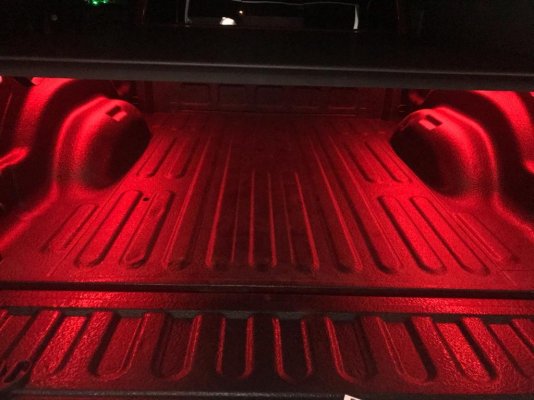

Also
I LIKE!
RED does NOT screw up your night vision!
That's good info. I noticed some new police cars now have all red interior lights.
The switch panel will be upgraded as soon as I get out of this apartment. Bldg a shop in the Spring. This was all done in our living room. Wife was REAL impressed. NOT!1de23dd847973f83ea112a38593a4a23.jpg71e9870c8489c5fa76cba95b0ca05846.jpgc89e0fb2fcfb35603e7b65355307d54b.jpg
