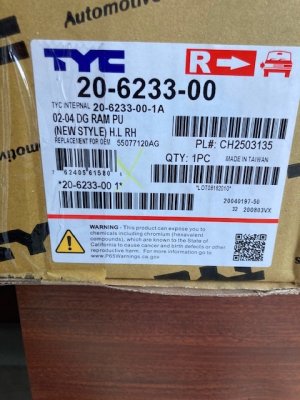

I replaced aftemarket headlamps for 2004 Ram 1500, easy swap, bulbs came pre installed. Upon turning on the lights and then using turn signal I get a "lamp out" message on display and a bell signal with every flash. no upgrade to LED done. What is next step?

If the headlights aren't LED, are the turn signal lights LED? That would explain it. If the turn signals are LED then you'll need to install an inline resistor to each. I needed to do this when I installed LED signal bulbs.

Thanks All for your response. I did swithc ou the old turn signal sockets for the new and it all works well. Appreciate it!
