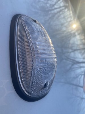

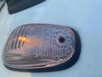

Update:
Spoke with Ram Customer Care on the phone again today and have a case number ... I also have an appointment at a dealership for next Tuesday with their water damage assessor ... the warranty department was very polite and pretty much stated that as long as there is no sign this damage was caused my the user they will cover it even though I’m beyond the 36,000 miles
It is pretty clear to me at least that this is a case of exactly what that device bulletin is about
You can see the one light out and then all the moisture under all the lights ... the one light that’s working has a crack

I have noticed that the clearance light issues seem to be with the newer style lights with the mounting screws in the front and rear of the lights. I don't recall issues with the lights when the mounting screws were on each side of the light . I have not personally owned the newer style but I guess I have had 5 Rams with the previous style and never an issue. I'm wondering if the curve of the roof makes it easier to crack a light with the newer style light. May be a fine line between tightening enough not to leak but not to tight enough to crack the light.
My 2013 and my 2016 had the same lights and no issues. The problem he has and why the bulletin came out was that "batch" was over torqued at the factory. So yes if you over tighten them they will crack.
Makes me wonder why they switched the mounting holes. It used to be the MOPAR lights had the holes side and the aftermarket had front and back mounting holes like the OE lights are now. Maybe they switched suppliers . Might be time to switch back if they are that much of problem .
