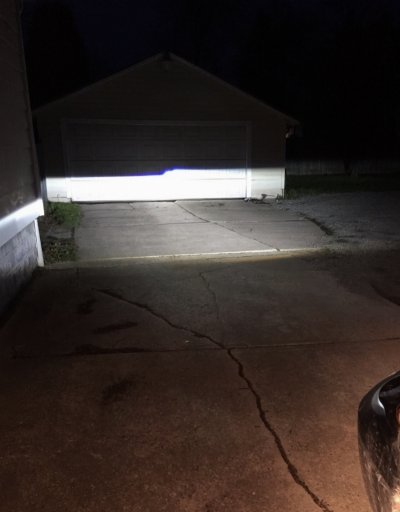

So this is my 2nd set of LED headlights. I originally had regular halogens in but I did not like the brightness or yellow color. I upgraded to 8000L Auxbeam LEDs. They were nowhere close to the brightness of the regular halogens, so i bought a 12000L headlight and they are brighter, but the whole beam is just messed up. I dint know how to solve this..... For some reason the camera makes it brighter. In real life they are a whole lot darker and it makes it really hard to drive..... Any idea how to fix this??? Btw I have 50w (I think) resistors installed too3b274531e960ebb7ffa7ada21c5743f3.jpg

With all the money you spent its time for a retrofit. 4300k HID morimoto projectors will give you the brightest most useable light per wattage. Only very slight yellow to an otherwise white color.
Or you can get 5000k for pure white, or 6000k for slightly blueish white light to the same degree the 4300k are yellowish white.

Unfortunately, the standard reflector is not optimized for an LED bulb and that is the main reason you are seeing issues. Go back to a standard halogen bulb like crazykid1994 is using and you will be good again. Or do the projector retrofit like chrisp2493 has. If you don't want to do the retrofit yourself, there has been good feedback from several forum members on these headlights off ebay which is the route that I plan on taking.

I cant buy those cause I have an 06 lol. But I do have a pair of old light that I may try to retrofit some projectors. If not I’ll do HID or Halogen.

I hope you don’t mean HID in your reflector housing. That is stupid bright, and blinds people on the road (even in daylight, had that happen to me a few days ago). A morimoto retro fit is about $300, that would cover bulbs, ballasts, resistors, canbus harness, projectors, everything you need. If you look on The Retrofit Source, use code TRS10 for 10% off [emoji1303]
Retrofitting is actually pretty easy, especially if you already have the talent to weld up your own custom bumper. You’ll love the light output, you’ll never want to go back to regular lights again

I just installed fluxbeam X’s into my factory projectors and I like them, brighter than the halogens for sure. I had HIDs on my last truck with morimoto projectors and they are a million times brighter I just didn’t want to deal with screwing resistors into my frame and holes in my dust caps. Also idk if it’s just me but I think the cutoff step on projectors looks stupid. I don’t know why I know mostly everyone likes the clear look of the cutoff but I just hate that look it’s too ricey for me I prefer the flat cutoff look that most OEM projectors display.
