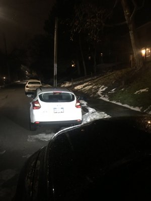

You may already be aware and are going to roll the dice, but everything Ive seen LEDs just don't throw the light downward as do HID or halogen. Not mention the requirement for relays/resistors.
Ive projectors but went with Sylvania ZXE's and its a nice white and doesn't break the bank.
GL
Fogs example, Driver's side ZXE...
