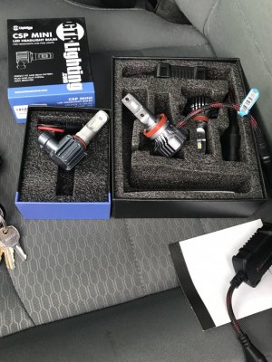

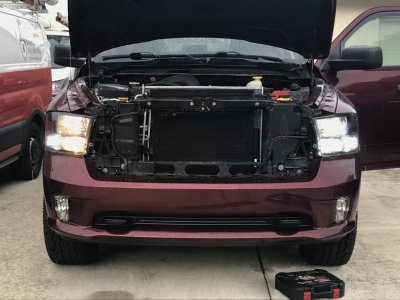

Well, I finally got these led bulbs installed, last. Isn’t.
The katanas do in fact fit in the low beam socket, with the back of the bulb fan area actually snug against the cover when reinstalled, but I thinks it will be ok - time will tell.
I didn’t try the katanas in the high beam spot, but given how tight that area is, I honestly don’t think they would fit..... the comparison between the katanas and the max5 led bulbs I got for the high beams - the max5’s are noticeably shorter on the back in the fan area than the katanas.....
Clocking of the katanas is easy and 100% and 360 degree adjustable, allowing you to get them set exactly, while in comparison, the other bulbs I ordered and installed in the high beams - the Max5 bulbs only have 3 positions for clocking, so I have them in the high beam spot, unfortunately they will not clock to have the leds at 3 & 9.....they will line up at 12 & 6, or I have them in now and they approximately at 2 & 7.....
I have not had the chance to road test at night with the bulbs, or to check the beam patterns on the garage door, but will do so as soon as I can.
I was surprised to find I was able to install high and low beam sets without decoders, and when I was done and tested all for function around 6pm (still plenty of daylight) I had no errors on the dash for lights out, and no flickering - I sure hope that continues.
