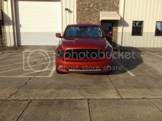

25" bar is as big as you can go without removing or modifying the tow hooks IF you want the light recessed in the bumper. CJC (i think) makes a mount for a 30" light but it sticks out from teh bumper to clear the tow hooks. When I did mine last year 25" bars were hard to find so I went with a 20". When this one fails it will be replaced with a 25" curved.
20" light bar and relay wiring from amazon.
I made a bracket that mounts through the licence plate holes with SS bolts and nuts. Got about $60 in the whole setup.
