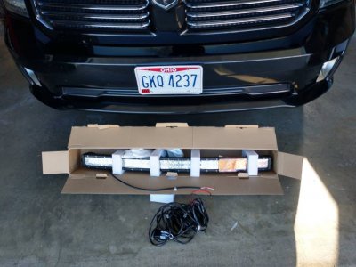

I recieved the light bar via UPS today. It in fact has what appears to be 16 gauge wires coming from the light bar itself. The wiring kit i have laying next to it has 16 guage wires. So its pretty obvious it does not have a 800watt draw. Nevertheless, i am awaiting a few other parts before i install. Since the bar has day running lights i went ahead and got amber covers to mach my amber day running lights on the truck.

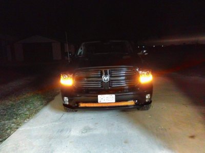

This light bar is definately NOT 800watts. Nevertheless it is a nice addition to my truck for night driving. Also the amber covers make it look really good and i expect will protect the light bar from any kind of stones or whatever.

As a general rule of thumb, each LED is typically either 3W or 5W. So with 100 LEDs, the max actual wattage would be either 300 or 500 watts, respectively.
My 40" bar, for example, contains 80 3w LEDs and is advertised as drawing 240W.
Looking at your pictures, it appears to be identical to mine.
Their claim of 800W is ridiculous.
