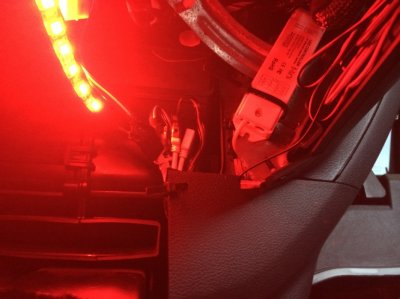

Here are some photos I had taken post installation to give you an idea of what it looks like finished and where I hid the controller module and wires. Bare with me, I'm using an iPhone for the pictures and uploading.

This photo is the area I described where I zip tipped the controller module to some metal frame work and also zip tied all the connections from each led strip behind the plastic L shaped piece. Where the strips connect to the white connectors off the module, I electrical taped where the connections were made. This picture is when you open the door and crotch down and look to the right of the gas petal.

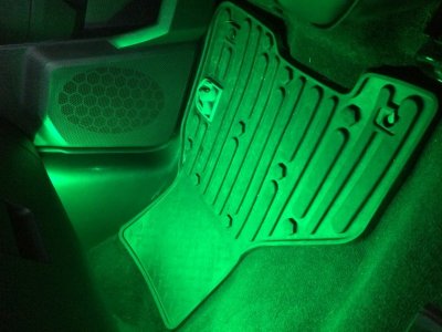

The next two pictures show a couple different colors during late afternoon still very bright.
