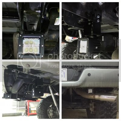

I wouldn't suggest hooking them up straight to your reverse lights. LED pods are far too bright to be running in crowded parking lots at night. You want the option of turning them off when needed. I have mine hooked up to a simply SPST (on/off) switch so I can run them whenever I want (reverse, hooking up a trailer, unloading cargo, etc.) Some guys will also hook them up to SPDT (on/off/on) switches so that they can be on with the reverse lights, off, or on whenever needed.
I also went a bit of a different route with mounting my lights. Rather than cutting holes in my bumper for flush mounts I decided to build some brackets and install them back under the truck a ways. Keeps them a little more hidden for a cleaner install IMO. Doesn't effect the light output at all having them back that minor amount.

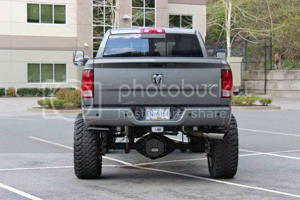

Top picture is standard LED reverse lights, bottom is with the 3" LED flood pattern pods.
