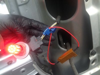

LED Resistors (turn/stop).....that work.

bigolayne
Mar 22, 2015
950
285
Springfield, MA
Yes you are correct. You may want to look at some other options for splicing into those wires. I like to solder mine now because I had a case where those connectors didn't make a true connection and then later hyperflashing.
Rzrman328
Rzrman328
Aug 25, 2014
5,808
3,153
The treeline
I usually double tap electrical stuff...the t-taps and then heat shrink over it. Nvr fails.
Don't have the patience for soldering lol
