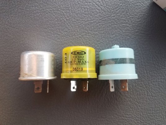

Does anyone have a mfg. and part number for an LED compatible electronic flasher that is known to physically fit inside the 1997 fuse panel?
I've seen several specifically listed for 98+.
I've also seen reviews for others saying they don't physically fit in the fuse panel.
I know there are pig tail extensions, and also resistors... just trying this first.
Thanks!

I think the length is the issue.

I ordered the CEC Industries EF552, it fits in both flasher positions (Hazards/Turn signals) with the access panel on and works without a problem.
I have LEDs in the front, the rear is standard equipment. The blue/black stripe is the one I replaced, due to no flash with front LED turn signals.
The only thing that might be an issue... the CEC isn't quite as firm in my truck's socket as I would have liked. Time will tell if it rattles out.
