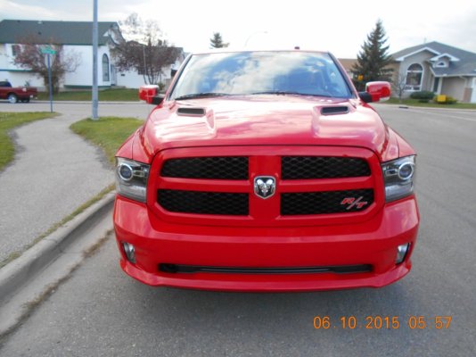

This is a 14 Sport front end,if your fogs don't look like this,somethings been swapped.2nd pic is after i swapped out the grill inserts for the honeycomb inserts

I was wrong about the horizontal fogs - I was going by a picture my wife sent me to veryify that it has projector headlights - I could see the fog at the bottom of the picture and from the angle I would have sworn it was horizontal.
