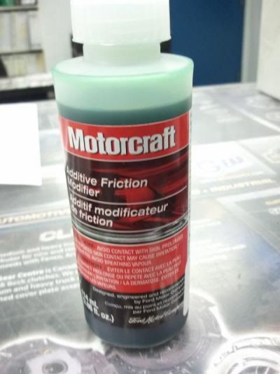

So that said I prolly won't hit the Track this year as the Installers are a sponsor at our Track. LOL. The Auburn Book states to change the Fluid at 7500 miles or Manufacturers rec. Interval, so that said I will stick to the 30 K interval (18 K miles) but will prolly do it sooner. Interesting enough the Auburn Friction Modifier was not used as it gets clumpy and cloudy in storage hence they used Ford Stuff which is listed and recommended in the Auburn Book.

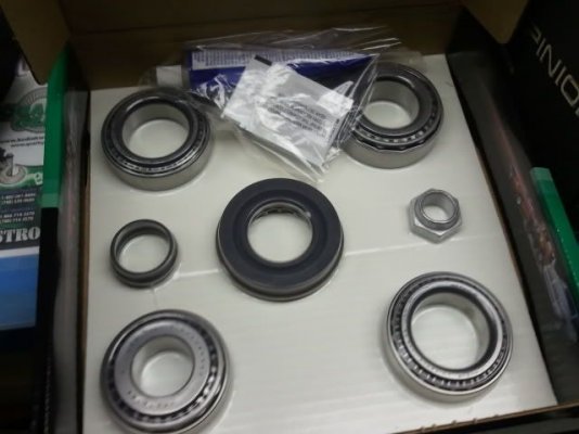

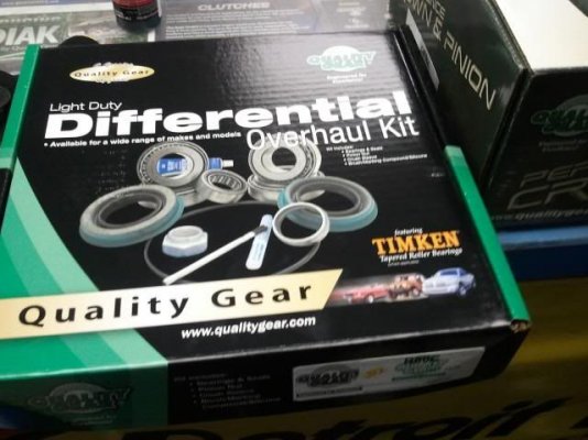

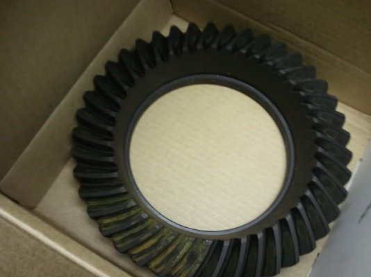

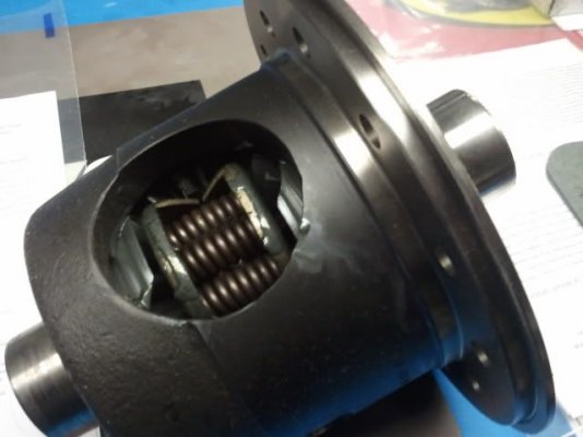

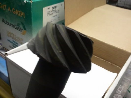

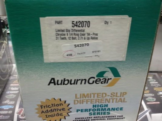

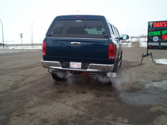

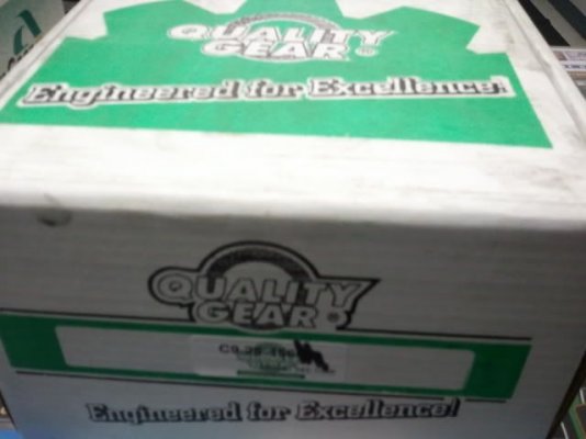

Some Pics and comments WRT the Gear Job.
Some of the Parts:
Rear Gears:
Auburn;
Modifier as per Instructions (Yeh I know FORD):
One of the 2 master Kits:
Front Gears:
I also provided the Shop With:
1 x repainted rear Cover, new Rubber Plug, mopar chrome bolts,2 x O-Ring for front 1/2 shafts and 4 x clips for 1/2 shafts and diff axles.

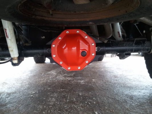

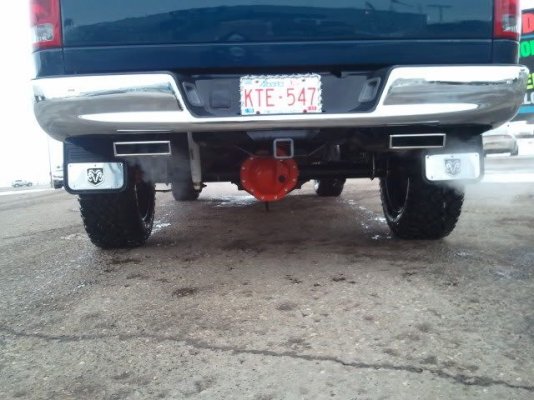

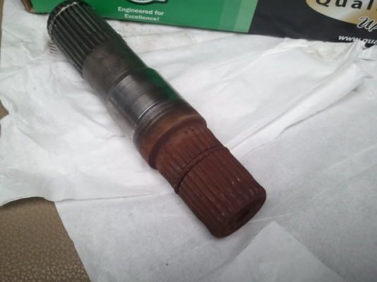

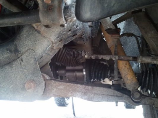

Everything went smooth. Rear took 6.6 hrs.
Front took 7.5 hrs as it had to be removed and built on the bench.

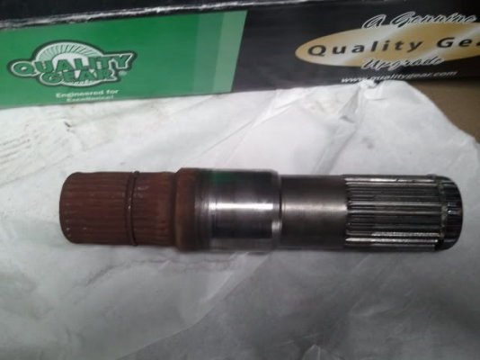

Good thing I provided a new short diff axle as the old one was chewed like a carrot and had ruined the 1/2 shalf Spicer Pot splines, so I ran them over a new one (1/2 Shaft).
Last Feb i had replaced both half shafts on the truck and the other longer front axle which was worn out. At the time I figured the other real short axle shaft was serviceable so I attached a new 1/2 shaft to it. So I guess i forgot the O ring as it was also full of water and rust, so an Important thing those rubber O-rings. I guess all the Data-Log Runs didn't help and I did notice a shakin from hell the last time I did that in 4 HI.
The N/S One, which would barely hold the 1/2 shaft spicer pot, and with 4 new clips we know the axles won't come out , nor the 1/2 shafts slip-off.

Well, Sorta. The roads are all ICE everywhere. I went out today and am about halfway done the break-in. I let her go about half throttle from a rolling stop and went sideways and after i got traction kinda spunout again up to about 4 grand, backed off and let her shift through at about 3K. Kinda wimpy but i got an Idea of what it will be able to do. As soon as I get some decent pavement I will let her rip for sure, meantime will continue to granny around.

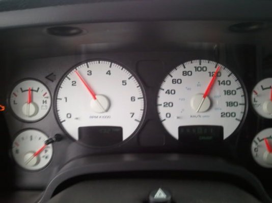

At 77 MPH I am reving about 2400. (Don't worry bout my CEL its the P300 caused by the Cam, Nothing to worry about).
Other pics where blurry, but at 80 MPH she was about 2500 RPM, and at the speed limit 110 KPH (68.3 MPH) she was hitting the HEMI Sweet Spot (2200).
