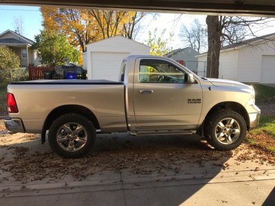

2014 Ram 4x4 Sport regular cab
Ok so my local 4x4 shop is recomending a ready lift leveling kit and Nitto Grapplers 35x12.5x20. I do want to level and put 35's under it, just wondering about the Readylift level kit? What do you guy think? $616 installed and aligned for level kit And $1834 listalled for tires

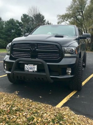

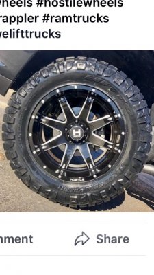

I can vouch for the Nittos-I have 35X12.5x20 ridge grapplers and I'd recommend to everyone-no noise, aggressive tire, seems to do fine in snow and rain so far. I got all four of mine for $1600, tirebuyer.com. Just watched a video from Custom Offset yesterday about lift kits and tires-they are big on rough country for the price (kinda entry level lift)-I actually have on my truck and seems to be fine. They also are big on the Ridge Grappler tires. Said most of the trucks they are doing they are using the nitto ridge grapplers. I do like those Falkens, almost went with those because some buddies have em and really like them. My cousin used Bilstiens on his ram and he likes them for what its worth. My rough country 3.5 lift was $750 installed. IMG_3743.jpg IMG_3853.jpg IMG_3851.jpg
