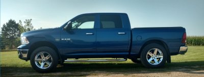

I have searched, read, and asked question after question. However, the time has come where I am about ready to throw in the towel on having a leveled RAM.
My history with leveling in my 2009 has went, Bilstein's @ 2.8, down to 2.1, down to factory. Then to Rancho Quicklift's, then back to a new set of Bilstein's @ 2.1.
My truck @ 2.1 sits higher than many Ram's @ 2.1. I am about 40 1/4 from ground to center of my front wheel well. I currently love the stance, but I am struggling with the new front end noises that have developed. Between the clunking when almost at full lock, to feeling the suspension creaking when coming to a stop or turning, with no real solutions found online I can't help but wonder if my level is just too much for my truck. The rancho's only gave me about an 1" height over the Bils at factory ride height, and the stance resembled more factory then leveled but I had no front end noise with them also. Mind you the noises that are occurring are not Shock noise but steering noise.
Do I throw in the towel? Do I drop the Bils to 1.4 and see if that resolves some of the noises? Is it time to look at Zone's front differential drop? When do I just give up?
I've tried to do everything per recommendations. Despite being an 09 I installed the Zone UCA's, I installed the MaxLinks Leveled Sway Bar End Links, I've replaced all my LCA busings, I made sure the washer was installed on the piston rod, I replaced my factory top plate & spring seat just in case I did some damage with the first set of Bils when I installed the washer in the wrong place. So what else is left? How do I get this truck looking as they should, yet not sound like I am driving something that the tires are going to fall off of.

The picture above is set at 2.1"? That looks like 2.8" or higher. Are you sure the coil cup was installed correctly when the struts were assembled?

I agree it sits stout, always has. I am pretty certain everything is installed correctly. I've done this install so many times that I even started second guessing myself this time around, so I posted questions about installing the top plate, and the top spring seat. Even though I thought it was pretty self explanatory. I had a local mechanic with years of experience confirm that I had the struts assembled correctly before I put them back into the truck.
I currently have the C clip in the 4th Groove which is the 2.1" setting. I'm at a loss.
I do have 275 65 20's installed.
