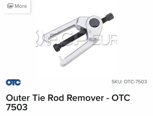

What tool works best for separating the UCA from the knuckle? I've worn myself out pounding on a pickle fork, pounding on the UCA and knuckle themselves. I've tried craftsman's separator, but it is too small, and another (larger) separator that was also too small. I need 3.75" or more to push the bolt up through the joint. I've borrowed a ball joint separator kit from the local auto parts store, but it is the wrong type, and too big and bulky to fit behind the knuckle. Do I have to take the damn thing completely off the truck?
Can anyone recommend a tool for this?

Thank you for the responses. After considering your feedback here and other forums, I decided to go with the Bilstein 5100.
