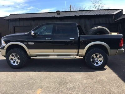

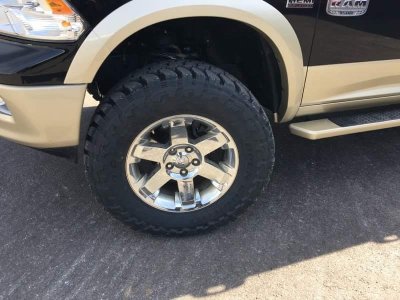

I just put 37x12.5 r20 on my truck on factory wheels. I used 2 inch wheel spacers and have no rubbing at all. I have a Zone 6 inch lift with bilsteins at 2.8 and 5 inch rear spring. It can be done!

If the 20x12 are a -44 like most are...you will need some additional lift like the second poster has with the bils.
Wheel spacers added with no bils and only the 6" on 20x12 -44's, will almost certainly rub as you'll be pushing your wheels out farther without additional lift.
Another factor will be your tire choice...one tire I had rubbed and another didn't....same lift.

You'll need to add a body lift on top of the suspension plus Bilsteins if you want to clear 20x12 and 37's with minimal trimming/rubbing. Anything lower will require quite a bit of trimming.
Realistically you need the 6" lift with Bilsteins at 2.1" or 2.8" and a 1.5" body lift at a minimum.
As Rzrman stated, wheel spacers will make your issue worse not better so those aren't even something you should consider.
