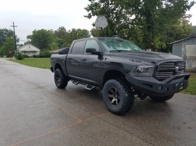

My lil guy barely fits in the garage...
6" BDS w/ 37's
Had to put a low profile antenna on, which bumps the bottom of the door.

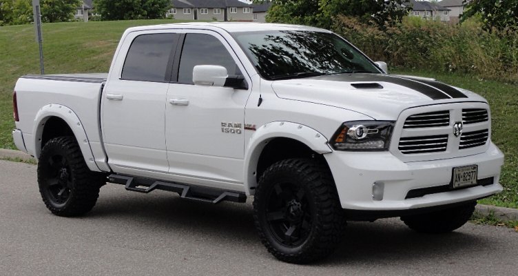

Zone 6/3 with 35s

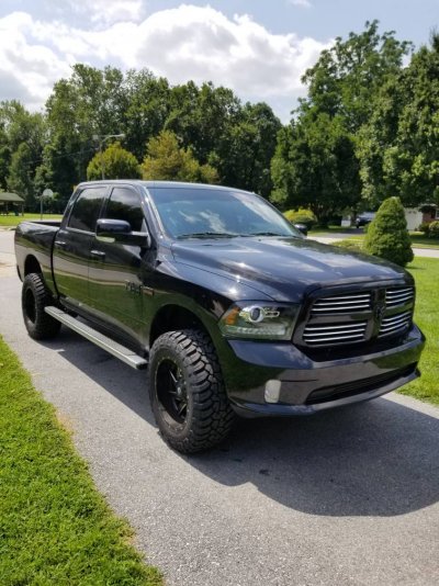

Zone 4 inch lift with 35's. A 6 inch lift is only 1 inch difference.
