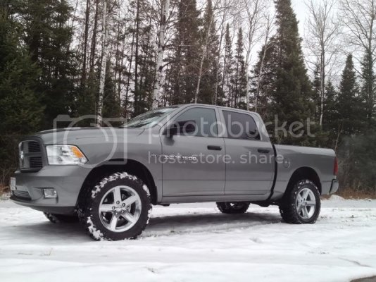

What will I need to fit 35 on my truck till I can pay for 6 in lift? Also does anyone know what rims match up in 20s to stock rims?
Reason is Im coming up to need new tires soon? If I go 33 I will be unhappy I think. Any suggestions?

2-2.8 level to fit 35s...stock chrome clads are 20x9 with around +18 offset/5.75 bs..if go with a 12.50" or wider will need more offset than stock unless you 1/4" wheel spacers or larger actual "adapters".

Ok so if I do the bilstien maxed out with rear spacer I should be able to fit 35 with a 1/4 wheel spacer.

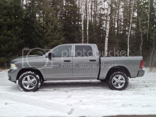

im running bilsteins at 2.8", 1.75" rear spacer, 35's with 1/4" front spacers.

ha and now you hate it on the hostages..i see what ur saying lol..but yeh i love the stock wheel look..just wanted to go bigger and didn't want to run adapters..but sometimes i wish i had the stockers mounted on another set of 37s to swap out sometimes

He means wheel spacers...don't go over 1/4" wheel spacers bc won't have enough thread left on lugs..I ran these also when had 295s on stock 20s on all 4 wheels..only needed on the front two but makes it look even if put on the rear also

I used gorilla 1/4" wheel spacers. Check with some of our vendors and I'm sure they can get you some. Also just measure your current rear end rake now and you will know what size coil spring spacer you would want..bilsteins maxed should pretty much level the truck without a spacer in rear, just depends on how much rake you want..check out topguncustomz.com, they have a lot of rear spacers
