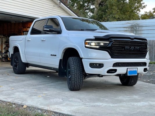

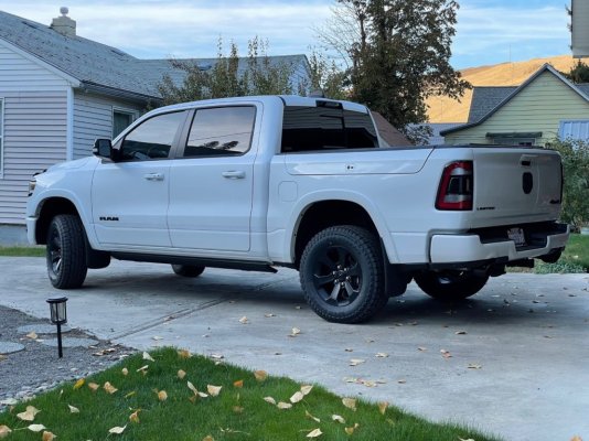

I used just the front. There was still a slight rake but it was close enough for me. And cost quite a bit less lol. I still have a couple pics...
View attachment 577198View attachment 577199

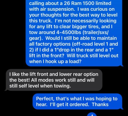

Nice. As I said earlier, according to the owner at Airlinks, if I use both front and rear links to level, I’ll still have full use of entry/exit all the way up to OR2. We shall see I reckon.

That's interesting because he was the person who told me I would lose OR2 either way because it's the front that has the issue. The links lift the front higher than stock, and the OR2 setting would be beyond the physical limitation of the front air dampers with the new front links. It really didn't matter to me because I never used that setting anyway. If he's now telling customers that they can retain OR2 they must have changed something. Maybe not going as high with the front and dropping the rear more than they used to? Just a guess but the owner seemed very knowledgeable and willing to help with any issues.

@mikeru or anybody else that can help...I wanted to follow up on this. I did end up with the front and rear airlinks, and got them dialed in where the truck sat damn near perfect. The problem was two things...
1. I lost the entry/exit mode. When the rear would come down, it would error out and jack the rear back up and put the suspension in service mode. Not a huge deal, but I like the look of entry/exit when parked.
2. The ride was pretty bad in all modes, felt almost like I was riding around on old school hydraulics, and would be harsh on pretty much any little bump. Leaving out of my driveway felt like it was going to rip the suspension out from underneath (like a topped out shock)
I took the airlinks off and am back to stock.
My perfect solution would be to bring the front up 1" and the rear down 1" (truck sits exactly 2" high in the rear), while maintaining factory ride, and air settings. But, I haven't been able to find anything that fits that bill.
I forgot to mention earlier that I do have the off-road package, so I don't have OR2. Entry/Exit, Aero, Normal, & Off-Road.
