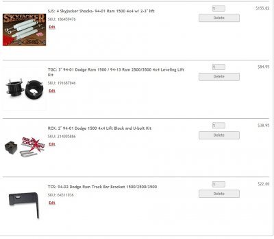

I am thinking about finally putting some lift on my truck but i am needing some advice. First off, i dont do any hardcore offroading and rarely haul alot of weight in the bed. Now i am hearing that adding blocks in the rear is no good from some people and others say it is fine. Below are the 2 kits i am looking at. I need some advice whether or not these are good, if i should get an AAL instead, etc. Thanks for the help.
Here is one, the other one is in the attachment.

Personal advice. Do a coil spacer up front. AAL in the back. Spend the extra $ on shocks (bilsteins) dont know if i spelled that right. The TCS track bar bracket should be ok, as long as your not killing your truck. you may or may not need Sway bar extensions, i wouldnt know cause i dont run a sway bar. Control arms - height dependent.

Look at the rough country 2.5 inch leveling lift kit. Spacers in front, blocks in back. If your not doing hardcore off road or hauling all the time it would be fine. I have it on mine and its pretty good.

I would just get 2" front coils or a 2" coil spacer for upfront, 2" AAL for the rear and some good shocks. At that height, no need for track bar bracket, sway bar drops or anything of the sort really. You won't notice 1" of height difference in the front really.
