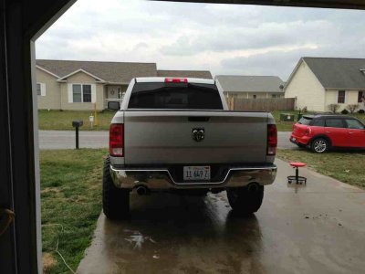

damn that looks good. will be 12 wides soon too :licklips: . what do your fender measure at? want a little more height on my setup

That looks sweet!
Got mine on order too, however slightly larger tires.
Are you rubbing anywhere when cranking the wheel left/right?
I don't see how it would, but thought I'd ask.

I'm not rubbing anywhere I couldn't believe it no trimming at all!
An they're -44 offset 4.75 backspacing
Ill get ya those measurements here shortly gettin ready to de badge

Are you going to do flares so you don't have all that tire sticking out?

Prolly not I'm just gunna let em hang

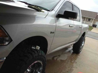

Debadged

chrome 20 clads are 20x9 i believe. so the math says, if i did it right..stock chrome 20's 20x9 with 5.5 backspacing. 20x12= 3 wider than stock plus pushed out 1 more inch (5.5 b.s. vs 4.5"). so that gives me 4" outward, add bushwackers of 2.5", i'd still be out 1.5" past the flares. does that sound right? the state troopers in town have a hard on for wide wheels

This sounds about right. Its 4.5" from fender. And 2.5" flares leave 2" hanging out.

do you have the 3"rear ? l assume so, don't look high enough for 5".

Ya it's the 3" in the rear
