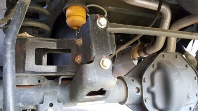

Hey folks!! Got a question for all you good people. I bought my 2016 1500 last fall and it already has a dealer installed Pro-Comp lift and 35's. I love how it rides but I tow a 18ft trailer and a heavy Pro street truck and the coil springs need some help. I was going to go with some helper bags but my lift uses the mounting tabs on the axle that say the airlift 5000 would use so besides the bags in the springs what are my other options? I know I'm not the only one to tow with their lifted truck. So Im really hoping yall might have some ideas or options or examples even! Thanks!!

There are a few options, but I'd check out Timber Grove........
https://timbergroveenterprises.com
I really like their stuff!! But I still have the issue of my lift not really being designed to accommodate their stuff either. Everything Ive seen im going to be making a new lower bracket no matter what looks like unless I just replace my springs for bags... Here are some more pics for information. Hope this helps.
