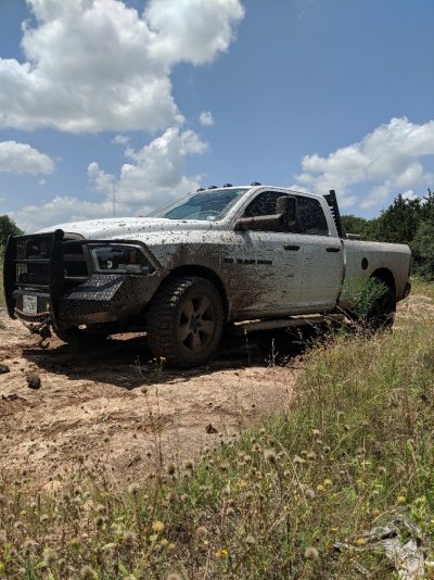

Got mine on bilstein 5100's. Looking to add a 6" lift to the truck when I get back from my deployment. Stock wheels just plastidipped them black.

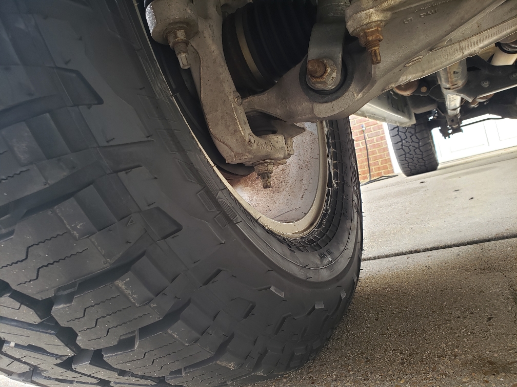

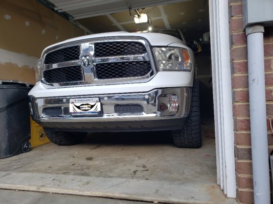

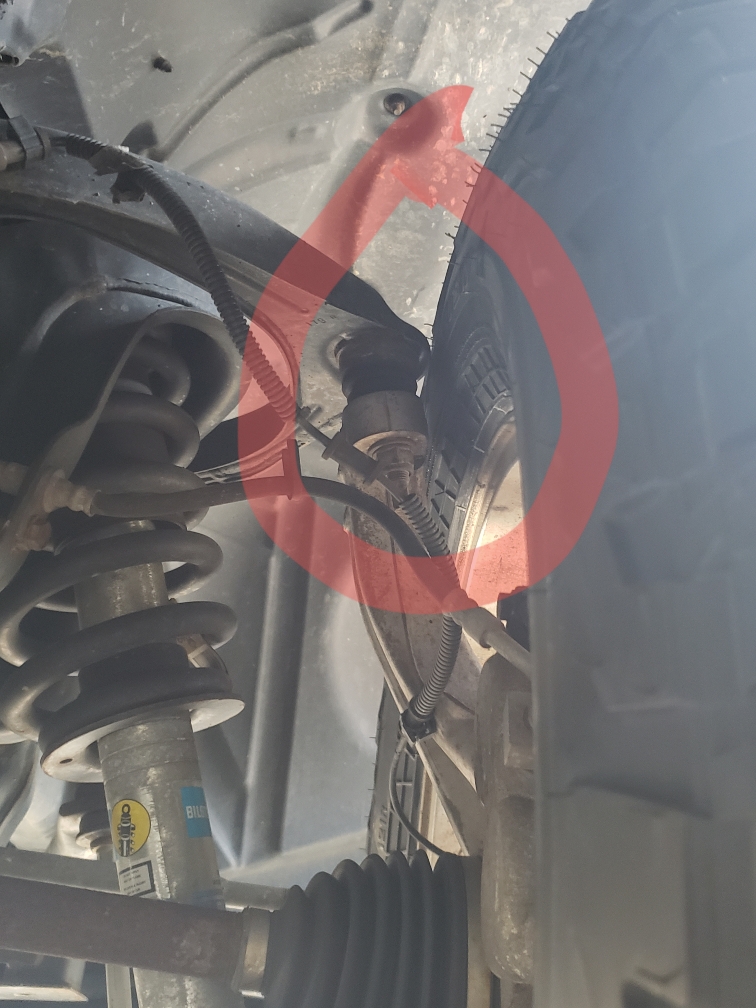

Leveled in the front with Bilstein 5100s 2.1" on stock sport 20s wrapped in Falken Wildpeak At3w 35x12.5s
I rub the control arm though so shes parked until I get the Bora 10mm hubcentric spacers. ETA 10 days.93a5e1b026f372875ebe5e0ef0427c4d.jpg7c02f9c03d535e9a93d26688caa416aa.jpg
Sent from my SM-G965U1 using Tapatalk
If your curious this is what rubbing on your control arm looks like (for others to learn)o_O
