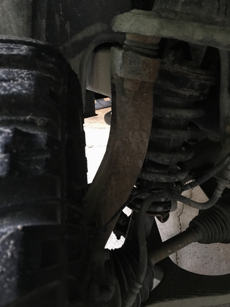

Not sure how the Pro Comp knuckles are shaped, but with my 4” RC lift, the clearance issue was between the tire sidewall, and the knuckle.

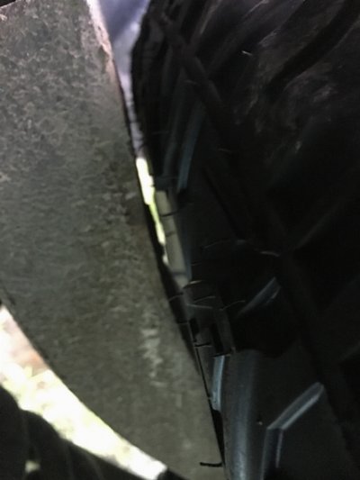

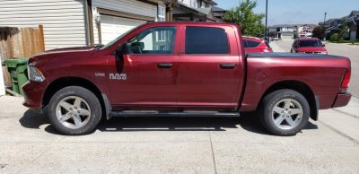

First pic shows clearance between tire and knuckle With a 1/4” spacer.
The 1/4” spacers were on the truck when I bought it, and were not hub centric. I ditched them in favor of some 2” hub centric ones.
Second pic shows clearance with the 2” spacers installed.
Oh yea, tires are 35x12.50’s on stock big horn chrome clad 20’s.
