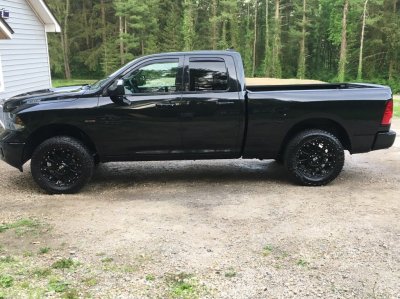

My 2018 blackout Ram with leveling kit and 1 1/2 wheel spacer.

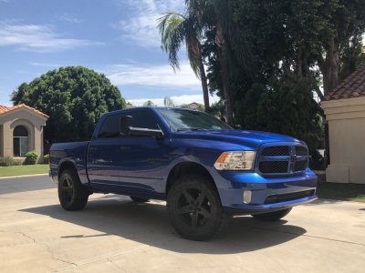

Not sure what kind of level mine has as it was installed before I picked up the truck..
My 2018 Ram absolutely love it!View attachment 135887
Come on now boys....read the thread title
I ain’t mad atcha but it does suck when people are looking for something and have to sift through random unrelated things for what they’re actually looking for.
There’s probably a thousand other threads your trucks would fit nicely in but I see no stock wheels in those pics....just saying.

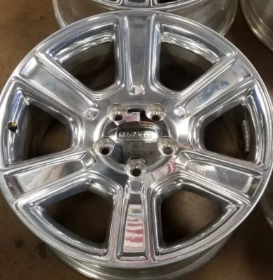

Going to lift this with a 4” Superlift & run the Laramie 6 spoke OEM wheels. Just worried about tire fitment with 35x12.5-20 or 325/60-20. Any body have any thoughts on wether it’ll clear the Superlift aftermarket spindle and not rub? Guess that all depends on the tire I presume, maybe use Bora wheel spacers? Like 1.5”. The truck is a ‘13 Outdoors man, and I still don’t know what that exactly means for ride height. Superlift states it needs an additional part with their 4” lift. I don’t know and Superlift tells me the front coil maybe different from Ram? I wish they had more confidence in knowing if it was the coil or not.
Any thoughts??
Chief_6.7
Chief_6.7
Aug 2, 2017
661
340
Any thoughts??
I’m sure the 35s will clear
6.7CumminsDrvr
The Dude abides………
Dec 6, 2011
2,060
1,429
Georgia
392
My 35’s clear with no spacers. Running 4” Superlift with same rims. They are close to the knuckle but they have not rubbed anywhere 17k miles and counting.
325’s will not fit without a spacer...........heck alot of 35’s dont. Check the tire manufacturers specs and make sure to calculate for a 9” wide rim. Most times a 35 x 12.50 x 20 will have soecs using a 10” wide rim but as a general rule for every 5” change in rim width, the tires section width changes by .2”.
For example 35x12.50x20 mounted on 20x10 will equal about 34.5” tall and 12.5” wide. On your 20x9 rim the tire will be about 12.1” wide which is about the max width without hitting the knuckle.
As for the front coil, the Outdoorsman and TX4 truck supposedly had about 3/4” higher ride height.......cant remember the 3 digit sales code
Hope that helps and EXCELLENT rim choice!
