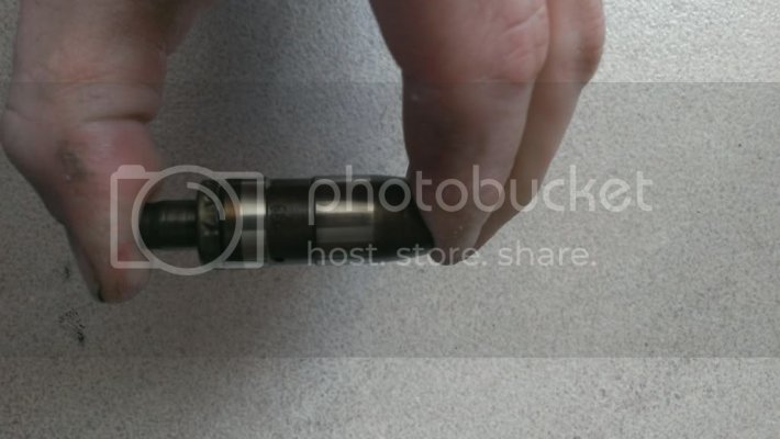

New not compressed.

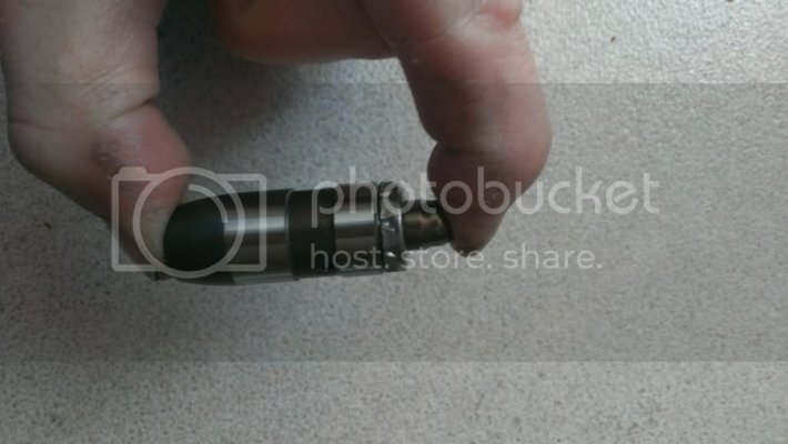

Compressed.

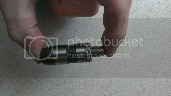

Old one compressed with all my might lol.

When some go bad they are really spongy and don't return or don't move at all. They should always be flush with the rocker but if its collapsed or stiff to me that will cause a tick.

So after thinking about this I realized that the new ones do not have oil in them yet so they should be easy to compress. That being said I would have to agree with bigsloth that if they are spongy with oil in them then they are bad.

New ones will indeed compress because they have nothing in them. You want them firm on the motor, if you can squish one its bad.

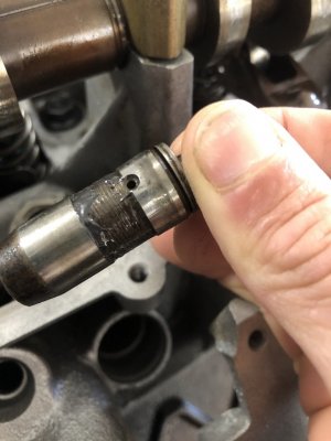

Reviewing this thread, after encountering different conditions of my lash adjusters... are really stiff ones bad? They move smoothly, with vise grips. Some are spongy.
I’m rebuilding my engine; and was at the stage of adding lash adjusters and rocker arm: to add cams on top. I cleaned them with WD-40, and used compressed air to clean excess off. oddly, two became very stiff when I sprayed in air in the tiny side holes. One was stiff the whole time. A spongy one became very stiff, when air blowed on and into the holes.
should I just replace them all? I have no interest in taking anything apart again.
I’ve been at this project for 8 months, and don’t want to waste time repeating a job. I got plenty of work I need to use my truck on, as it is.
