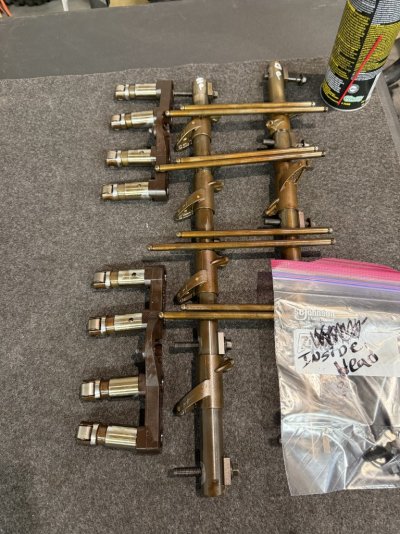

Ok, hopefully someone that builds these Hemi motors for a living can help.
I will try to make this short, but I have a 2015 Jeep grand Cherokee 5.7 L engine. The thing was running fine then all of a sudden it would run with loud valve knocking and valve train noise then the next day it would run quiet and normal, no power loss. figured maybe there was a problem with VVT or MDS solenoids, and or cam and lifters. So I replaced cam lifters water pump oil pump all the gaskets, torques all per the book. It was a lower quality kit i think probably out of china from ebay store. I did not measure cam lobes but setting side by side looked good.everything went together nice . Old cam gad two lobes with a small amount of wear. Never found anything that would cause such loud noise. Replaced vvt solenoid, replaced mds solenoids all new parts. So back together and motor sounds like an old typewriter consistent ticking like to much valve lash. Soaked lifters in oil, used assembly lube, checked preload its at .065 . Runs good just noisy power norma, no codes after driving for an hr. Then a cylinder 7 misfire and started running ruff, pulled motor apart a second time found #7 exhaust lifter pushrod cup loose and internal plunger jammed to the bottom. And one of the mds side activating plunger stuck in, inside the lifter. Replaced the lifter, could not see and damage anywhere, everything looked good. Put head back on , motor running same sound. Like lifters not pumping up. Runs good. Oil pressure from new pump says 30-49 at idle and upto 70-80 at higher rpm. Push rod balls look good and round, pulled valve cover to see oil flow and i have lots making it to top , rocker arms don’t show signs of severe wear. Where could i be losing oil pressure? Or could it be crappy lifters? It sounds like all lifters and rockers are making noise unmistakably. Any help would be so appreciated. Should I spend the money get oem mopar lifters and cam?
