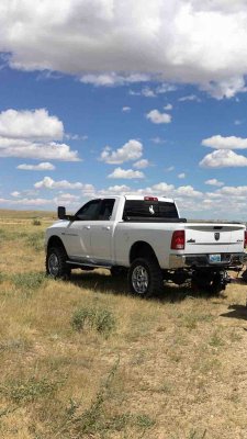

Here are two I've had done with rough country . However the black is 6" rough country 3" pa body lift and bl5100 in all four corners white is identical with out the 5100

What's on your white one.
