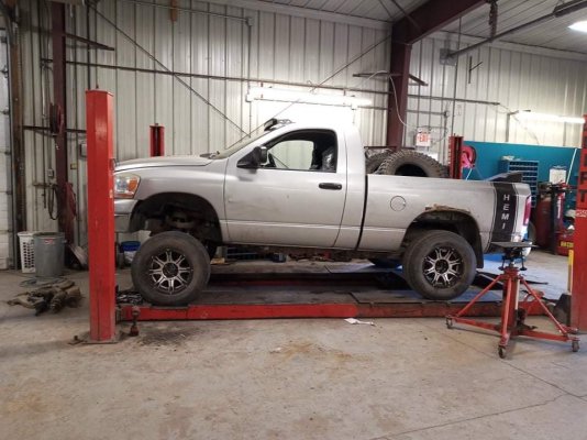

Lifted my 07 hemi 4x4 6 suspension and 3 body not a single regretted. Rear isn’t done in the picture I’ll get one tomorrow if I remember Tire is a 275/70 (33.2x10.8) putting 35’s on when the snow goes away.
